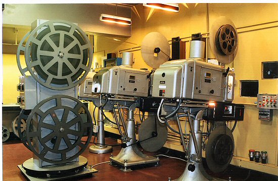

Inspired by the discussion in this thread;
Westrex Tower Capacity w/36" reels
I though it might be a good idea to survey best practice today, especially considering Health & Safety legislation.
Though many people say they've no problem lifting 36 inch reels if the feature isn't too long, the fact is that even a 6-reel title is still 25 - 30 kg in weight, and is officially too heavy to lift unaided, most especially to high level.
So...should best practice today be to use low-slung side-by-side towers, e.g as one would find on the Kinoton FP25D or the Cinemeccanica B4000, B5000 and BS bases for the Vic 5?
Making up onto 6000ft reels on the bench first seems an agreed way of avoiding lifting the 36 inch reels, but what is the best arrangement for splicing on the tower or the projector base? (I've seen people balancing splicers on high stools, and have found it difficult myself to do the job properly).
In short, if you were to open a cinema today with towers, what would be the ideal way to work it ergonomically and also comply with the H&S requirements?

quote: Pete Naples Westrex does, sort of, you sit it on top of the control box.
True, but it's not ideal; it's rather too high for many people, and also rather narrow. If you're not careful it's not difficult to tip the splicer off the box as you press the handle down. Also, on a double-sided tower you really need a shelf on each side, or one that can be moved from one side to the other, to aviod either having to always make up on the same side, or work wrong-handed.
quote: Pete Naples I really don't care for the cinemecannica tower at all, you can't control it. Also parts for earlier mocels are now all but impossible to obtain.
The Phoenix, East Finchley, had to replace theirs with a Westrex one a few years ago when something broke that they couldn't get spares for.
I still prefer to work with smaller spools than with any type of tower.
