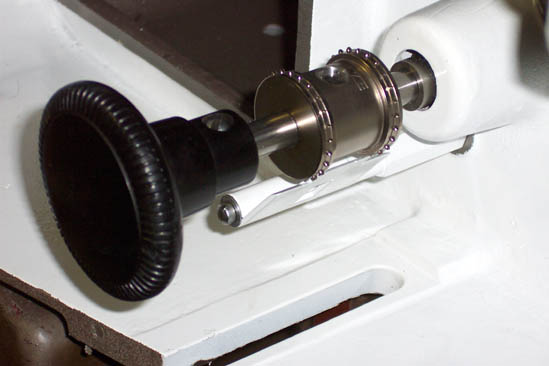

Thats very possible Will. We have done this before and use a giinding place that's local here. So far they have done very nice work for us. We also use them to do a clean up pass on sound drums and to widen the groove in the DP-70 sound drums. The VKF sprocket in the upper photo was bored out by yours truely on a lathe with carbide tooling and lots of coolant. We wanted one to place in service for 6 months before having the batch made up. Its well hardened metal I'd say a 55c to 60c or there abouts. Boring it out on the lathe was not easy but was certainly possible as you can see.

Then it might work out for you..... Is the end of the sprocket notched to couple with a mating part on the movement? If so then we're out of luck since we didn't have the notch done.
