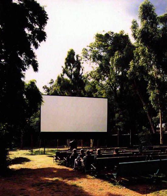

My outdoor has a permanent screen which is 10m wide and sits above the ground level by around 2m so the image is well up into the air.
It is engineer designed and consists of 3 x 100mm sq galv tube legs sunk into concrete with 3x 50mm sq galv tube rails bolted onto brackets welded to the legs.
The top of each leg has a windstrut (50mm SQ Galv tube) each bolted onto another bracket and then each of the 3 struts run backwards about 3m from the rear of the screen and are also sunk into concrete in the ground.
The screen face is steel sheet called Sign White here in OZ and is rivetted plus stuck on with a caulking material onto 25mm SQ galv tube frames which are then bolted onto the 3 horizontal rails.
Face is painted white with a matt vinyl acrylic paint which has an anti mould additive in with it to stop the face slowly going spotty with mould.
It sits outdoors all year and gets a spruce up each summer ready for the season. Sometimes this amounts to a repaint and other times it is just a scrub down with sugar soap.
Black border painted around for the scope ratio and W/S fits in the middle of that so on W/S there is a painted edge only top and bottom.
Speakers (column design) L & R are mounted on brackets, centre has the HF horn up on top and a big wheeled bass "W" bin with 2 x 15" bass speakers plus powered sub woofer stuffed inside the big box as well as crossover for HF & LF speakers and DC power supply for HF horn magnet (an old multi-cellular flare type... big and heavy).
Been like that now for 10 seasons... number 11 coming up and apart from replacing the odd rivet it has never moved in quite strong gusty winds we get here.

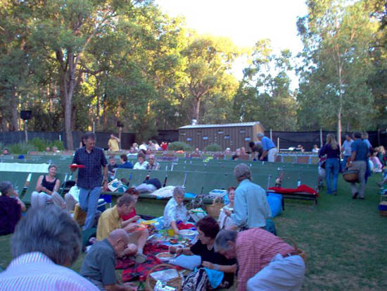

 - posted 06-19-2006 09:01 AM      Profile for Paul Trimboli   Email Paul Trimboli   Send New Private Message       Edit/Delete Post
Here are a couple of photos of Lindsay's outdoor he sent me a while back. Hope you don't mind me posting these Lindsay.

Marin, The normal type cinema screens, perforated/fabric/plastic or whatever are a pain in the butt IF you have much air movement as unless they are pulled up really tight the flexing away from or towards the audience drives the projectionist NUTS... if he is watching the screen.... as the focus goes everywhere.
There is one outdoor 15m wide normal perforated cinema screen here in Perth that is in a sheltered area and does not get much wind movement and image is VG BUT there are a couple of smaller ones that when the breeze gets up they are dreadful to watch.
I don't have that issue as it will take a cyclone to make mine move but even so on windy nights I can often hear the steel sheets "pop" and occasionally I have to replace the odd broken rivet.
Rain does not seem to bother the perforated screens or even the plain flat plastic ones. I used to have mould issues but finding a paint that had an anti mould additive was a great help and the dust that settles on the face just cannot create mould over winter when the area gets very damp and cold.
