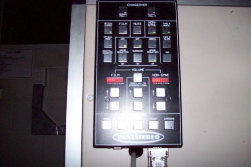

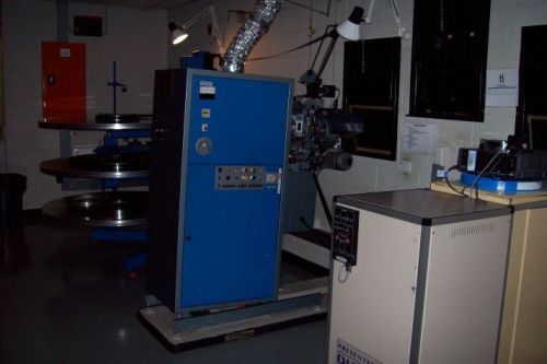

Steve,
Of the 16 screens only 4 have Panastereo stuff, the rest are Dolby Cp500's.
The Panastereo's are just very old (circa 1995 vintage) I'll get a photo and model number today.
Ive never seen those remotes before, and I hate them. Why there is a seperate 'film' and 'non-sync' fader is beyond me, after all the automation computer does not require two.
Cameron,
Hmmm, West Ryde eh, where do you work? Private mail me. Let me know if you need anyone after xmas. (I'll be avail) How's Mitch going????!!!
Do you think the battery would be in the remote or the proccessor (I think the 4 are cp1200's) Regardless of the battery being expired, there must be some how to command the thing to go to a preset volume at bootup. (without putting in a fake 9am session 'House-up, NonSync,Fader 7)
Bill.

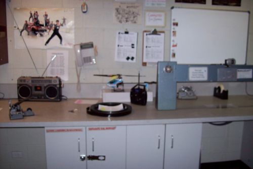

John Hawkinson
Posts: 2273
From: Cambridge, MA, USA
posted 11-17-2006 01:24 AM
Hey, in our primary booth with custom automation, we have 5 remotes in 225 sq. feet. Of course, we're a manual changeover booth and we mostly use them for format selection, esp. during our trailer reel which frequently has mono and SR, and sometimes other stuff. One remote at each 35mm projector, one at the 16mm projector, one at the inspection bench, and one on the microcontroller itself.
I suppose if we were designing the system this century we'd have wireless
--jhawk
