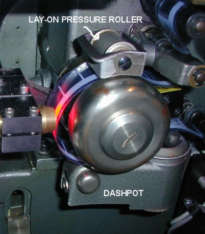

I would guess you have an out of round or stuck lay down roller (the one above the sound drum) or a dent in the sound drum.
There is also a dashpot (a shock absorber below the sound drum that requires fluid).
That will do for a start.

The "brute force" roller on top of the sound drum may of never had the roller bearings oiled and may have developed a flat spot. The outside part of the drum has a cover plate with a center screw, remove to check if the outside endbell of the drum is properly square and seated on the shaft; this end is held on with three screws and a locator pin. The fit of the end bell is tight to the shaft and sometimes people do not reseat it properly or evenly tighten the screws. Finally bearings on the main shaft or someone may have dropped the sound drum endbell on the floor during as service check.

damping fluid is the most often culprit I have found or the set screw on the collar that sets the spring tension on the lay in roller has shifted

Dash pot requires a special fluid, not a motor oil. It can be ordered in and is supplied by cinemacanicia who make the projector, genuine is good. It resembles baby oil, not projector oil.

It is a silicon damping fluid that is made for many dash pot applications

Sorry to sound so new.. but, I've looked around the sound drum (big silver bell shaped gizmo) and cant see any kind of fluid indicator or even an input? We dont have a manual on the machines and I've not had much luck digging one up. Is there a standard place where I can check the level?

Just to the right of the sound drum you either have a little casting with a "tank" with a spring loaded assembly with two small rollers ( dashpot assembly ) that the film rides on top en route to the last film sprocket...or....a pair of rollers mounted on a spring loaded swivel bar ( economy flutter roller set ) which requires no damping fluid. If there is nothing but a flat spot on the projector casting with some threaded 4 or 5mm holes, then you do not have this "accessory" [Wink]
In emergency, for short term use, I have used castor oil available at most pharmacies on off beaten travels.....it doesn't cure the Cinemeccanica but the patient is able to give a presentable response. [Big Grin]
John Walsh
Posts: 2490
From: Connecticut, USA, Earth, Milky Way
Registered: Oct 1999
 - posted 01-11-2007 07:13 AM      Profile for John Walsh   Email John Walsh   Send New Private Message       Edit/Delete Post
Here's a picture of the sound drum for a V8, which (for this topic) is very close to a V5.
