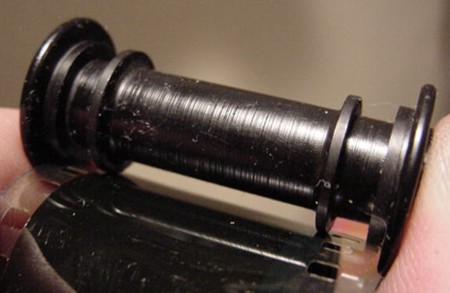

Well, since Monte posted a picture of it, I'll ask. What is the point of those rollers? I never understood. Most of the Christie machines I used to service had those as their pad rollers.
 - posted 06-07-2007 10:39 PM      Profile for Brad Miller   Author's Homepage   Email Brad Miller       Edit/Delete Post
So did older Simplex/Century projectors too Ken.

Thanks for all the replies. The picture of those rollers looks like the same as what my projector uses. Im not doing anything high speed through it though but I can see where if those were used on a transport at high speed it could be an issue.
 - posted 06-08-2007 02:12 AM      Profile for Monte L Fullmer   Email Monte L Fullmer   Send New Private Message       Edit/Delete Post
I need to add this comment on my pict: this pad roller came from the middle pad roller assembly which this roller is mounted on the front of the pad roller arm and this roller is holding the film as it leaves the intermittent sprocket to the middle constant speed sprocket.
If the lower loops are built too small, the inside of the lower loop is what is making contact with the inner shoulders of this particular roller and doing the base side scratching.
Chek with your local supplier for non-shouldered rollers to replace these shouldered rollers for your make of machine.
-Monte

I agree. I've long since replaced all those double-flanged rollers (or whittled off the inside flanges) wherever I found them, and never had a problem as far as them keeping film in place.
Maybe the idea was to give an extra bit of insurance when running beat-up prints with nicks and split-off edges - something you don't see much in the polyester era.
 - posted 06-09-2007 11:56 PM      Profile for Monte L Fullmer   Email Monte L Fullmer   Send New Private Message       Edit/Delete Post
I do believe that the shouldered roller concept came from the nitrate era - to keep the film securely centered on the sprocket since the constant speed sprockets on those early machines travelled a lot faster in rotation speed (16tooth) and a tighter film wrap making it prone for film hop off the sprocket.
The 24tooth XL sprocket was a blessing in the long run by slowing down the rotation speed and making a larger film wrap around the sprocket, thus less curve stress on the film.
Also, those early machines had brass pad rollers equipped with the same inner shoulders.
