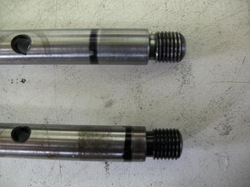

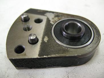

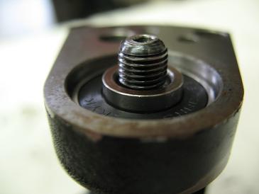

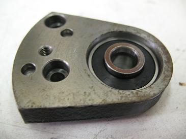

Here is my upgrade for the horrible outboard bearing design on the Christie Ultramittent. One of the most common reasons for failure on this intermittent is due to the fact that the inner bearing race will slip against the starwheel shaft, resulting in the bearing wearing a groove into the shaft, I see this a lot in my shop, sometimes it's very extreme. This doesn't come as much of a surprise considering that the surface contact area for the bearing only measures aprox. 3mm wide, my upgrade takes it to aprox 9-10mm wide. I marked with a sharpie pen on two separate starwheels to illustrate the difference. I've done hundreds of rebuilds like this and have yet to have one come back with any apparent wear issues. The replacement bearing is pressed in flush against the back side of the bearing plate, I coat the inside of the bore with high strength Permabond retaining compound, so the bearing isn't going anywhere. Bearing part number is 88038.
