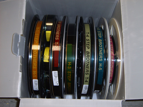

Topic: A massive Thank You to whom ever is responsible for my print of Step Brothers
posted 07-25-2008 12:18 AM
Rewind Reel#2 from the shipping reel to a house reel first. Next, rewind Reel#5 from the shipping reel to a house reel or you can use the empty shipping reel from Reel#2. Set Reel#5 aside for a few minutes.
Build Reels#1, 2 & 3 onto a 6,000 foot (or other large size) reel. Take this time to visually inspect the film as you build. Rewind the entire first half of the movie onto a second 6K reel.
Spin the first half of the show onto a platter and continue working on the second half at the bench. (Come back and check on it every couple-few minutes.)
If you don't do your trailers as "drop-ins," be sure you put them onto the big reel before you spill it onto the platter.
Now, start with REEL#6 and build it TAIL FIRST onto a big reel. This is a perfect time to put all your cues on the film and be sure they are right.
Finish up by splicing Reel#5 (previously rewound) then Reel#4. Again this is TAIL FIRST. You built up Reels#6, 5 & 4 in reverse order onto that other big reel and they are now heads up so you DO NOT have to rewind.
If you are good at your job you will probably be finished with the second half of the movie at about the same time the first half is done spilling on.
Attach the head of REEL#4 to the tail of REEL#3 and finish spilling on. When this is done, you should be ready to roll.
Yes, I agree that the bone heads in the lab could have very easily shuffled reels so that they are all heads up or tails up but we're just going to have to get used to this.
After a while, you'll learn to puzzle it out and figure out what the best way to build up any print is, given a random orientation of the reels.

Joe Redifer wrote:
"So which way do you crackers prefer to get your prints... all heads or all tails?"
Like you, Joe, tails up, since I do not have a platter reel either. Also, since I am building on 6000's at the bench, it's easier to place cues, as the emulsion side is up.
Additionally, I find that most of the trailers come tails up as well.
If I have multiple prints, I will open and inspect all cans/boxes first. That way, I can "mix and match" to save time rewinding if I find same reels in opposite orientations.
