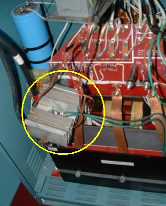

 - posted 01-15-2009 02:56 AM      Profile for Jim Cassedy   Email Jim Cassedy   Send New Private Message       Edit/Delete Post
Everytime I've had a rectifier "pop off" (which I assume means tripping a circuit breaker when you try to ignite the lamp) it's turned out to be a bad/shorted diode.
Last time this happened to me was in September.
A negative diode in the rectifier shorted out.
Unfortunately I discovered that the last time a "set" of replacement diodes was ordered, they'd sent all positive diodes. (D'oh!) And of course this happened over a weekend when getting a quick replacement locally was almost impossible.
I pulled the heat sink off of an old exciter lamp power supply and drilled it out a bit so that I could mount one of the positive diodes on it. Then, I connected the positive diode "backwards" to the rectifier with some heavy wire and hung the whole thing in the back of the unit until we could get a replacement overnighted that Monday.
It worked fine! Below is a picture of what it looked like:
Only lost one afternoon show on a busy weekend,
and the boss was happy with the quick fix.
 - posted 01-15-2009 03:03 AM      Profile for Brad Miller   Author's Homepage   Email Brad Miller       Edit/Delete Post
haha Nice! Seriously, good thinking on a way to keep the show going.

 - posted 01-15-2009 06:57 AM      Profile for Kenneth Wuepper   Email Kenneth Wuepper   Send New Private Message       Edit/Delete Post
Jim,
Congratulations on being very resourceful. This shows that you really understand how the power supply and the diodes work. There are very few booth operators who could have done your improvisation and saved the week end as you did.
Well done.
