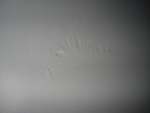

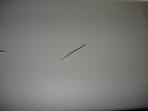

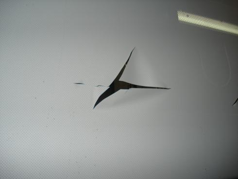

How we did a quick fix on a hole like that was place a sheet of typing paper behind the screen that was sprayed with an stick-on adhesive...kinda made a 'bandage' out of that piece of paper.
After we got the back of the screen initially stuck to the paper, then "rolled" the front so it would lay flat against that paper.
But, before one would do this, at the end of the tear, we would make a small round hold there so the tear would not grow any further, esp if you got a curved screen.
Only small glitch is when the tear is in the middle like that and to use this patch trick, would be the slight reflection of the paper behind the screen since that section of the screen had the holes covered up.
We had that patch up there for months before a new screen came in.
After that was all did and done, we should have used black poster paper to eliminate any reflection ... but, live an learn.
-Monte
posted 08-24-2009 09:23 PM
Instead of duct tape use white gaffer's tape or, if you don't have gaff, use white athletic tape.
First, tape on the back side to pull the damaged areas back together. Try to match the pieces back together as much as possible. It won't be easy because the screen is under tension but, if you try you can get it very close.
Once you have the pieces back together, use some more tape on the front to cover the hole(s). Finally, get somebody to put their hands against the taped area on the back of the screen while you press against them from the front so you press the tape down securely in place. (Use a white towel or something to avoid leaving marks.) If you are careful and smooth the tape out till it's very flat, you might be able to make an almost invisible repair.
I have repaired holes as big as my hand (like a "barn door" rip) with gaff tape and, from 10 feet away, you would have to squint your eyes to see it.
I had two screen slashed in one theater I worked at. The bastard cut about a 3 foot long gash along the bottom of one screen, right near the edge. It was very hard to pull back together but we were able to make a passable repair.
