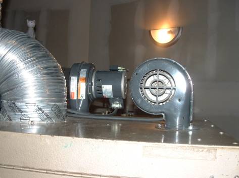

The "problem" was that in an effort to get maximum light
on the screen, a theater owner was burning a 2K bulb at
2700 watts and couldn't understand why they were burning
out every three months. ( [Roll Eyes] ! )
I convinced them to upsize to a 3k bulb but that required
making some modifications to their Xenex lamphouses.

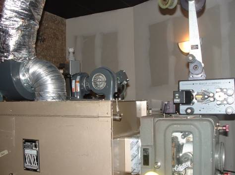

Here's a "general view" of the set up
The exhaust blower on the back was "orignal equipment"
installed because the theater had no roof exhaust system.
Here are the new blowers added to cool the 3K.
Fortunately I was able to borrow a portable
pnumatic steel punch to make the 2" holes on top.
The blowers are connected to a time-delay relay which
turns them on when the bulb is powered up, & turns them off
about 15min after the bulb powers down at the end of a show.

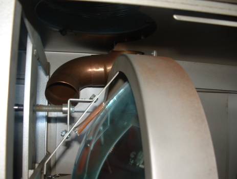

A pipe elbow & reducer directs air at the (+)end of the bulb.
2 elbows were needed to clear the mirror at the (-) end.
