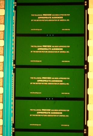

If you look at the films scanned in on another topic, you will see 2 dots that define the frame line and a bar that means "do not cut here." This assists splicing so that the left eye and right eye don't reverse.
I think this is a truly WONDERFUL idea. This should be extended to ALL prints of all titles. Finding the frame in a sea of darkness/confusion would end in one day. Louis

One of the really great things about the way they've done it is that the frame markings are visable even "in the black", so if you have a reel with a fade out or a really dark scene at the head or tail, it almost eliminates the possibility that you'll make a mis-framed splice when assembling a print unless you're really lame.

The picture from the other thread, originally uploaded by Jim Cassedy.

 - posted 04-04-2010 04:05 PM      Profile for Louis Bornwasser   Author's Homepage   Email Louis Bornwasser   Send New Private Message       Edit/Delete Post
Looks good, doesn't it? Louis

This is coming back to the sensible days when the film stock had a mark between sprocket holes every four perfs.
With multiple sound tracks on today's prints, that isn't practical, but Technicolor is to be commended if they expand this new marking to all prints, regardless of format.
 - posted 04-05-2010 02:11 PM      Profile for Joe Redifer   Author's Homepage   Email Joe Redifer   Send New Private Message       Edit/Delete Post
T3D's markings would seep into the picture area of real movies. It only works for T3D movies. But the area between the perfs on the non-soundtrack side are completely available. A dot on every frameline would suffice.
