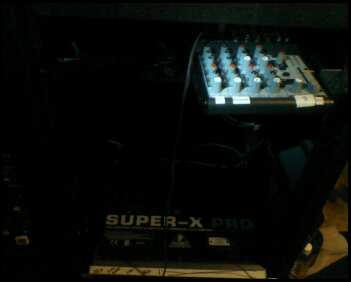

Ok starting with the racks, we only have a rudimentary sound system:

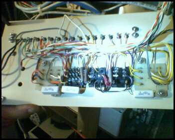

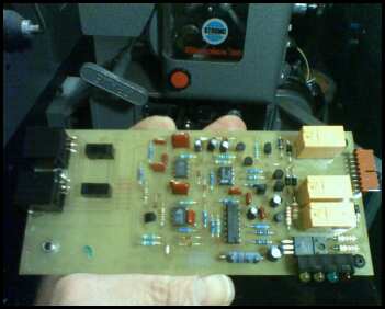

Then above the lamphouse, what I've assumed is the automation but without printed description:
Then to the failsafe also without identification that I could recognize:

That is a Raven/ Edlo automation and failsafe I would test the poser supply first the failsafe does need a stable 24vdc

Yes I did find 'Raven' on the printed side of the circuit board. Could you elaborate on finding the 24vdc power supply source location? Would that be the transformer on the upper left of the second photo? I will stop in for a look tomorrow between other jobs

I had a brief time to put a meter on the transformer, in the top left of the second photo. 120vac going in but did not get any vdc reading on the output, the two red wires. Seems to indicate a dead transformer. Oddly enough my coworker tried the auto start circuit again and it engaged. ? Intermittent problem vanished - but I'm sure it would return during a run. What to do now? I guess I'll check individual solder joints for cracks, and double check that transformer...
