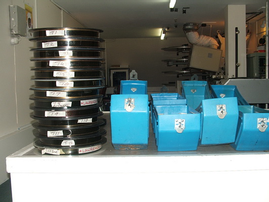

In fact its so unusual to have a film arrive in reels I took a photo of one.
Poor old "Lawrence of Arabia" this print had seen better days, however I should add "Doctor Zhivago" arrived soon after this and the print is not "to bad" after screeing Doctor Zhivago we sent it of to Aussie to live. [Smile]

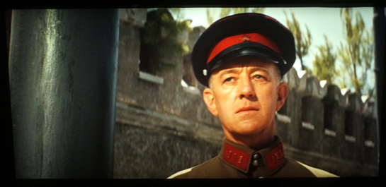

Jock that print could be still in Melbourne somewhere and would be worth getting. I last watched this film when I was young back in the 60s and watching again was a real joy....twice [Smile] I think this is where only the "look" of a film presentation wins out.
here is a screen shot taken from the projection room might give you an idea of its condition
Graham.
