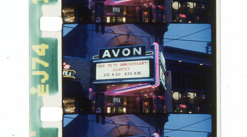

Super-16 is really just a camera format. It extends the image area into the space where the soundtrack would be on a 16mm print. This gives a wider image that is suitable for 35mm blowup or HD video transfer. Unless you are making your own films, you will likely never see a super-16 print, as there is no place left on the film to print the soundtrack.
edit: here is an example of a super-16 image; note how it extends almost to the far edge of the film and that there is no place for a soundtrack to be printed
