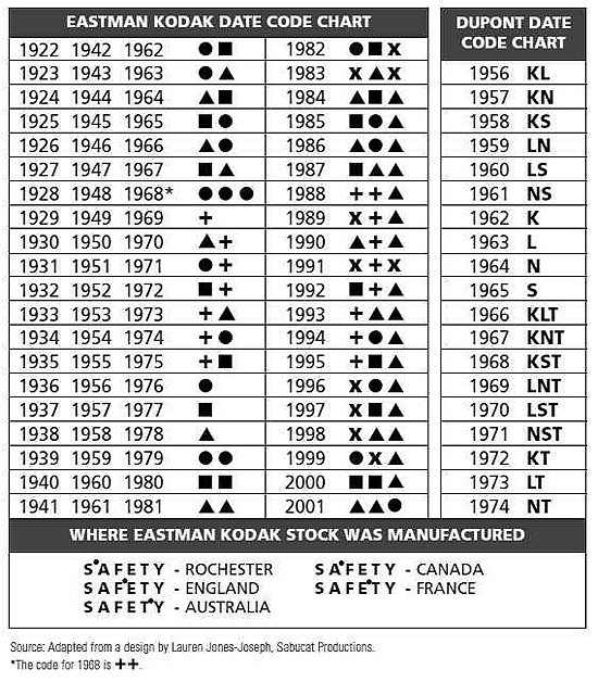

The following is a somewhat easier to follow chart, with credit due to Film-Tech member Jeff Joseph.
KODAK/EASTMAN & DUPONT
If the film is 35mm and marked SAFETY FILM, it was manufactured in 1950 or later. Note that the Dupont list is not a complete list.
FUJI FILM
Fuji uses a 4 character code, 2 groups of 2, where the first 2 characters are the year of manufacture, and the second 2 characters are letter codes indicating the quarter of the year.
JM - January - March
AJ - April - June
JS - July - September
OD - October - December
So 80-JS (may, or may not have the dash) would be sometime between July and September of 1980.
ALL OTHER FILM STOCKS
There is no reliable way to identify the year of manufacture for other film stocks.
