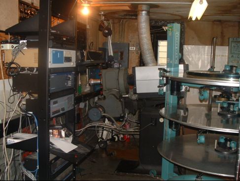

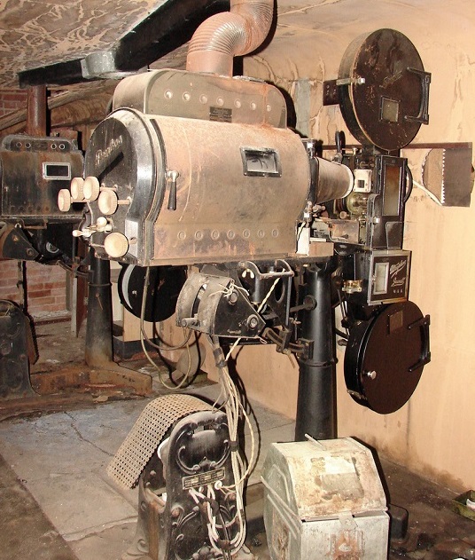

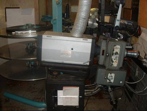

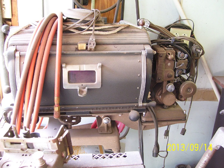

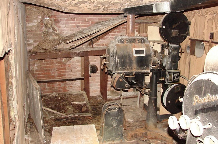

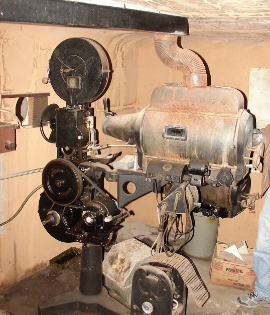

The lamphouse in question is indeed a Strong Utility 1KW lamp, they were the basis for the Simplex High also. The 16mms have Strong Junior lamps w/ 5.5 & 6mm sticks, the Peerless is the classic Peerless Low Intensity lamp ( 25-30 amp trim, manually fed sticks) that was also made for a very short time as a high intensity lamp w/ 1KW trim and optional motorized feed, but when the Peerless Magnarc HI lamp was introduced, the larger reflector and better working distance took care of the future of the Peerless Low. The Strong Victory lamp is actually unique, (I have a pair) They were very square in appearance and were only made in 1944 & 1945 out of non essential materials to support the war effort. They were very heavy too! They were basically a Mogul undercarriage with trims up to 70 amps and one lamp weighs more than two of the Strong Moguls! At 12 years old, I cut teeth on Strong Utilitys and Wenzel ACE projectors (at the Brockway Theatre at Lake Tahoe) soon they were upgraded to Moguls behind Motio AAAs that came out of the Basalone Theatre on Treasure Island Naval Base near San Francisco. The second booth I ever ran was a pair of Peerless Magnarcs behind Supers and RCA 9050s at the original Tahoe Theatre in Kings Beach for one summer, then the supes were moved to the new Cobblestone Cinema in Tahoe City and had the first ORC M-1000 Xenons sold by NTS at the time, My third booth worked was the Meeks Bay theatre with Magnarcs and E7s and RCA sound ran summers only. Then there was the Squaw Valley Theatre, Strong Utilitys, Century C, and R-2 soundheads. Boy, I'll never forget the early daysof my career!
