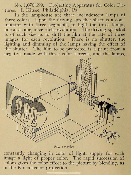

![](http://www.film-tech.com/ubbmembers/4115a.jpg)
posted 04-27-2015 06:49 PM
In browsing through a number of old cinema-tech magazines & patents, it seems that for a many years, beginning in the late 1900's, engineers were searching for a way to build a 'shutterless' or 'continuous motion' projector. Many different designs were tried using various combinations of moving mirrors, prisms & lenses, with varying degrees of success. All of them suffered from extreme mechanical complexity,and loss of light. The only practical shutterless machine I'm aware of was the German Mechau.
Strobe lights didn't come along till the early 30's. Experiments using strobes as a light source were tried, but strobes, especially the early ones, just didn't have the light output or 'recovery time' to put out a picture anything more than a couple of feet wide.
I believe there was at least one shutterless telecine projector made either in the late 50's or early 60's that used a strobe (I think it was a GE 'synchrolight') but someone here probably knows more about that than I do.
I do recall seeing a 'retired' one once at an old TV station some years back.
