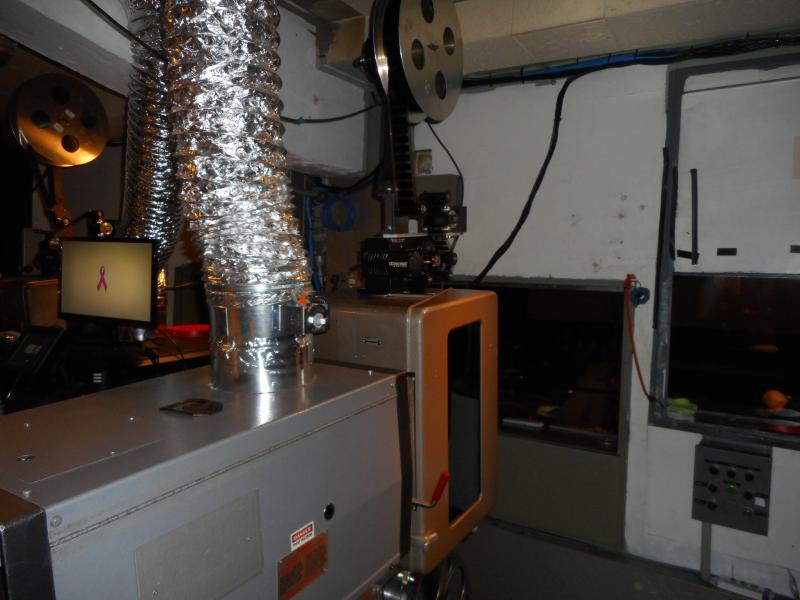

Heres a picture of whats being discussed here:
Obviously, this should never be done: the damage to the print can be irreparable.
Does anyone know which theatre did this? Theres certainly no good excuse for it.
