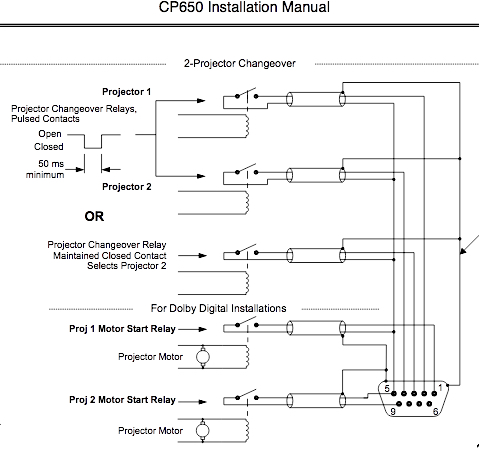

Try disconnecting everything from the 9pin "Motor Start"
connector on the back of te unit. Those sometimes had a
jumper installed which would do this.
Take a piece of wire or a clip lead & short pins 2 & 5 and
see if it switches to P1 when U do this.
(If I recall, the CP650 is shipped with 9pin plug with pins
! & 5 jumpered which would force it to P2 "permanently"
If that works, than the problem is with your wiring.

I could be mistaken but I thought the included 9 pin jumper only jumped the motor start signal for p1 to ground to enable SR-D playback from a single machine system?

Yes, Sean, you're absolutely right. I must have been suffering from momentary
mental dyslexia when I was typing that, and got P1 & P2 mixed up. The shorting plug
that comes with the unit would force P1 on the 650 for single projector (platter) operation.
. . and a quick check of the manual confirms this:
