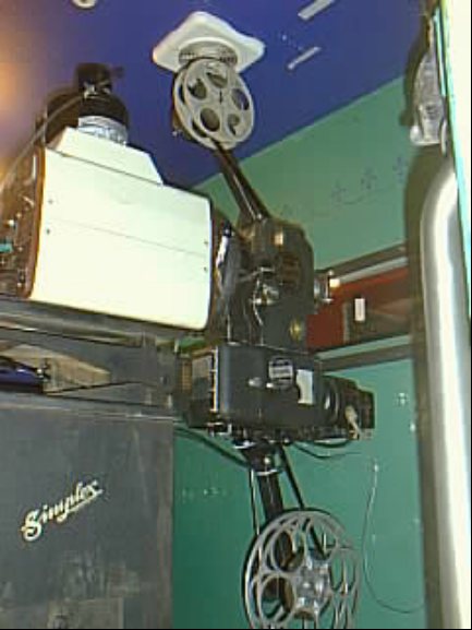

Here is a picture from John's collection that is an excellent example of a complaint I've had for awhile now. When is Kelmar, Strong or someone going to manufacture reel arms with a variable extension? This particular booth's height would have easily allowed for 6000 foot reels *if* the damned reel arms were not so long. Just look at that wasted space! I've been in that situation more times than I care to remember. Kelmar? Strong? Anyone listening? (BTW John, that "AW-3 Miniwind" on page 1 certainly doesn't look like a Christie to me.)

posted 01-12-2002 12:52 AM
Brad, that picture is an illusion! due to camera angle! They do fit 6k reels at the angle shown, however, a 6k reel would not fit with the arm straight up! Ken...The TECO arms were ok except they had the fixed drive pins for the reel (2 each) thus some house and today's plastic reels would not fit unless you were to saw off the pins, drill and tap the drive arm for an adjustable locating pin. And of course the 'split film failsafe' that Teco made was junk!!! Mark...Thanks for the info, I hope they do come back, they owe me about a years worth of service that has been paid for!!! ------------------ John Eickhof President, Chief Slave Northwest Theatre Equipment Co., Inc. P.O.Box 258 Wendell, ID. 83355-0258 208-536-5489 email: jeickhof@nteequip.com
