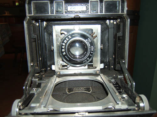

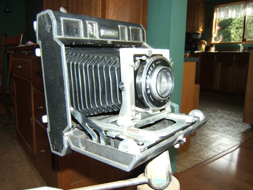

Adam,
That's a nice looking camera. Try looking at this site. It's mainly about the various cameras made by Graflex, but there's a lot of information there that's applicable to other cameras too.
Is it for roll or sheet film, and if sheet, what type of back does it have; can you post a picture of the back. This format can be a problem; large format roll film hasn't been made for many years; neither have film packs, but sheet film is still available, but only in a very limited range, and difficult to find. 5x4 sheet film is readily available, and it's not difficult to cut this down to the smaller size in a darkroom.
There may well be pinholes in the corners of the bellows; if they're small they can probably be filled in with a drop of rubber solution with some black pigment in it. If the bellows are beyond repair, and yours don't look like they are from what I can see in the picture, new bellows can be made for almost any camera by Camera Bellows in England. The quaality of their work is very good, and they're not that expensive.
If the camera has been out of use for some time the shutter may will be sticking, or the speeds irregular. And decent camera shop should be able to clean and lubricate the shutter, or send it for this work to be done.
I see your lens has a shutter with the old bi-pin flash sync connection; if you want to use this, and you don't have a cable for it, or the one you have is perished, they are available from Paramount Cords, in the Bronx.
Hope this helps.
Large format is fun, but a very different art to 35mm or digital phoography; take your time.
