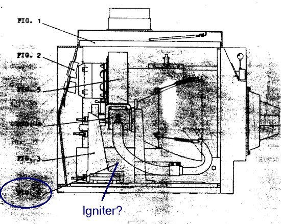

As far as the lamp not striking, as noted above, check all the safeties and interlock switches, as well as the auto-strike circuits, and the automation. You can always try temporarily feeding AC voltage directly tot he igniter to verify if it is working. If so, then work backwards through the wiring. I think you wil find the problem that way, usually a switch or connection.
